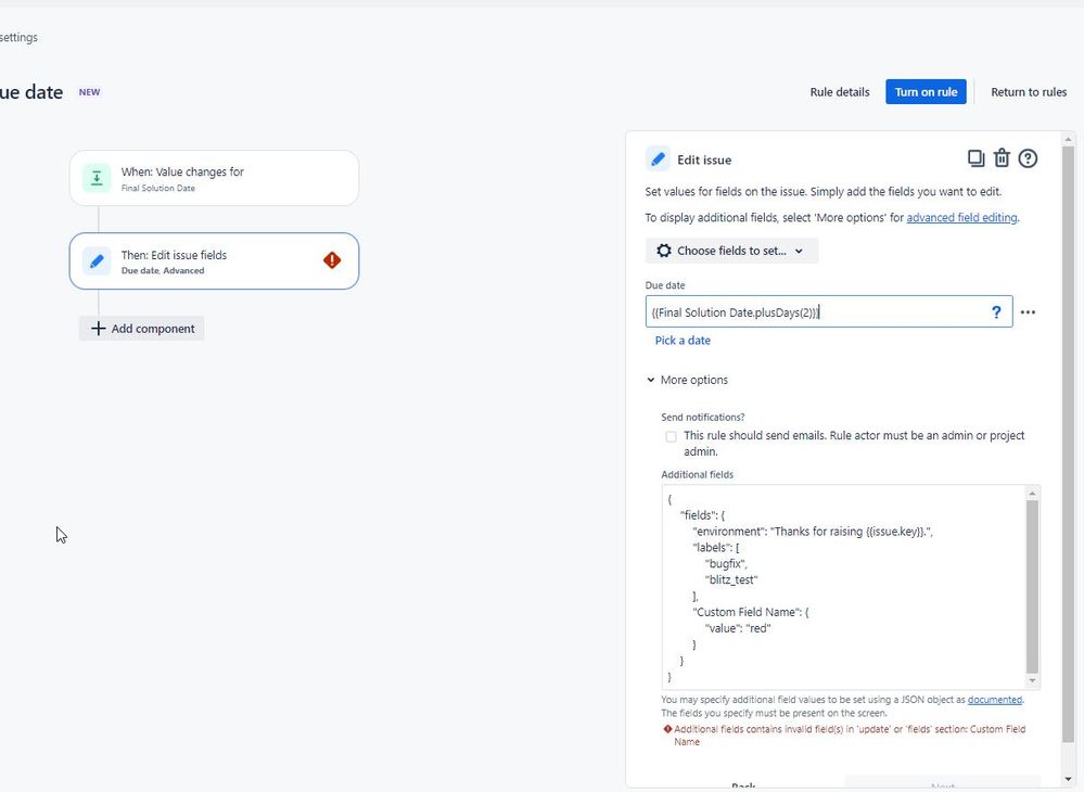

This is the automation, very simple, however it doesn't let me save it.
The error I think is really on the smart value which is not allowed.
Trudy P Claspill
March 11, 2024
There are two problems I see in this step, only one of which is highlighted.
First, the issue that is not highlighted is that you are using an incorrect smart value to set the Due date field. It needs to be:
{{issue.Final Solution Date.plusDays(2)}}

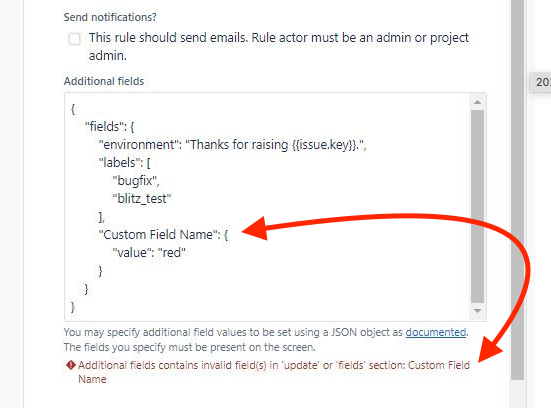

Second, the problem that is highlighted is this:
Jira is telling you that "Custom Field Name" is not a valid name for a field. What is the actual name of the field you want to set? Is it really "Custom Field Name" or is it something else?

Mattia Battan
March 12, 2024
I solved it by adding "issue." in front of the custom field name.
