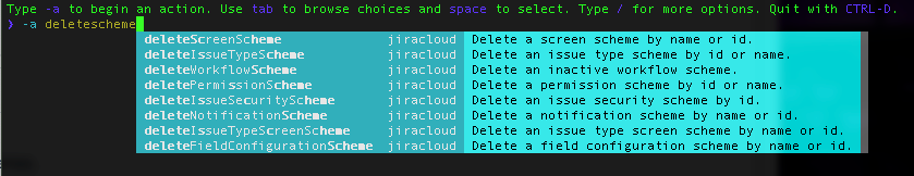

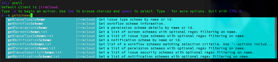

Yeah ACLI can totally both get and delete issue security, notification, and permission schemes.
I found this by using the super-cool ACLI Shell (introduced a few years ago) that lets you just type possible actions and it will suggest matches:
get various schemes
delete various schemes
As previously mentioned, you'll definitely want to test using --simulate, and if you can, use a Sandbox. (Great power, great responsibility, blah blah blah.)
