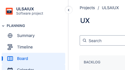

Sure thing... I have a board:

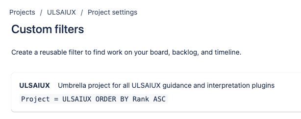

I have a custom filter for the project:

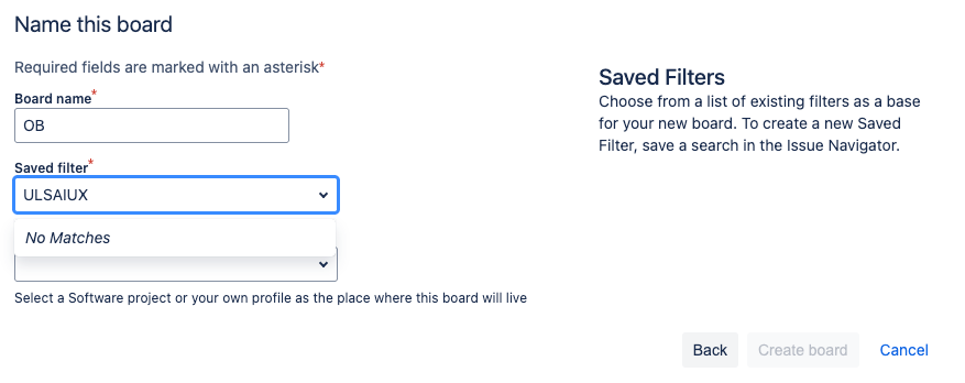

And when I get to the "Name this board" step, I can't find my "Saved filter":

John Funk
May 19, 2025
@Richard Benson  - Is this a Team-managed or Company-managed project? How did you create the board?

Team managed, and I had to request an admin create the original project and board. But now that it is created, it appears I have the ability to create boards in other projects, just not this one (which is why I am suspecting that perhaps it might be a permissions issue).

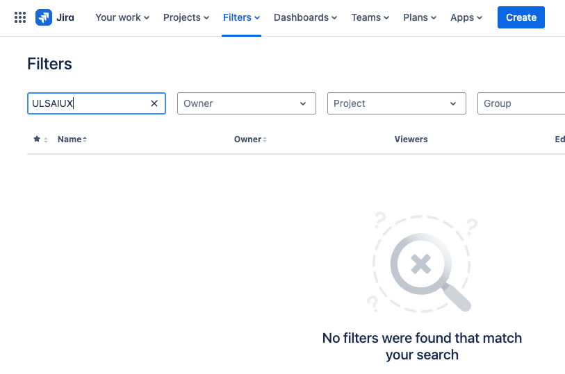

@Richard Benson So if you go to Filters in the top nave bar do you see your filter in the list of All filters
Richard Benson
May 19, 2025
No, it isn't showing up.
