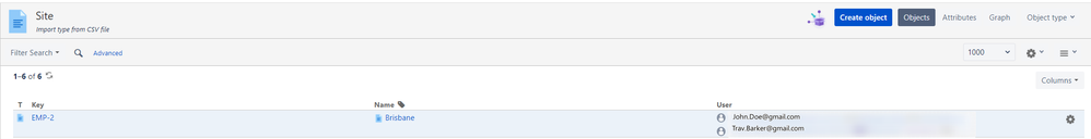

Yes you can do this, however you cannot do it from an attribute on an asset. The site actually needs to be its own asset for it to show as just the Site. The reason for this is that rather than just showing Brisbane, it will show as "Asset Name" and then in small text Brisbane. Like this:
John Doe
Brisbane
We've set it up like this. We have an Object Schema called Employees and in the Schema an Object Type called Site (or location if you will).
We then have an asset for each site name (i.e. Sydney, Brisbane, Melbourne). The asset has an attribute of User on it. The User/Employee/Reporter/Customer is then added to the Site and looks like this:

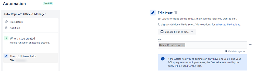

You can then configure your automation to look at the Reporter of the ticket, and select the Site of which they are a user.
This is the end result on your ticket field:ice_screenshot_20230309-160405.png

I would also note, it's important to make a copy of your automation and set trigger to when the Reporter field is updated as this may also require the site information to be updated.
You should have one automation for when the ticket is created and another for if the reporter is updated.
