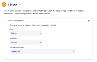

If:

I was using issue fields condition instead of "if block", and for the then part, I was using "Transition issue to".
Anyway I still have some strange behaviour after trying what you suggested. And I don't get why ...
I get for example the following error related to the "if" block:
Thanks for your help.
I managed to get away from the error I had yesterday, by restarting the rule from scratch instead of editing my previous one. However, I don't see the resolution being updated when moving issues to the "Won't do" column ...
