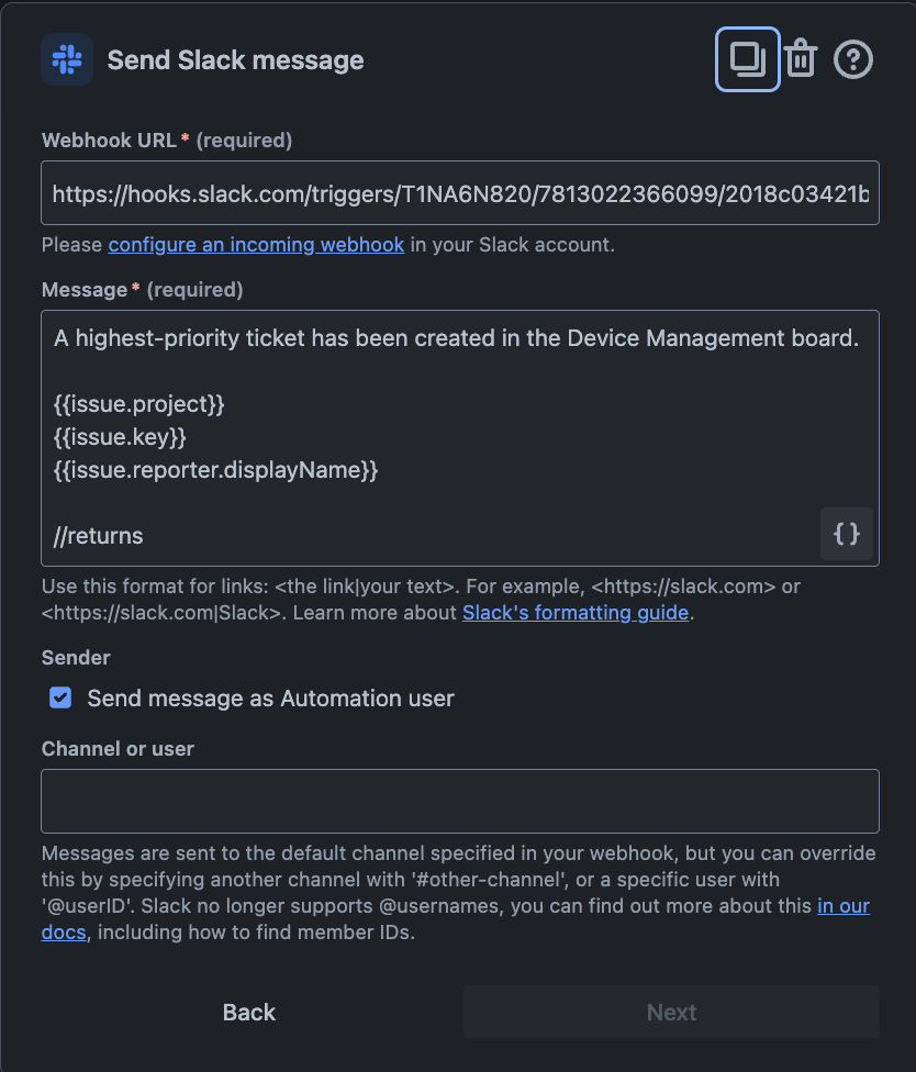

I’ve set up a Slack Webhook that sends notifications to a designated channel whenever a new issue is created with the highest priority. It’s working well so far, but I’d like to enhance the message by including the following details:
•Issue Key
•Issue Link
•Current Priority
•SLA Remaining
Here's how I assumed I would do this:

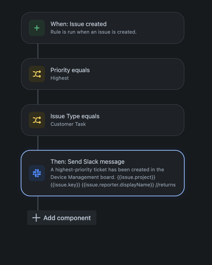

Here is the entire automation:

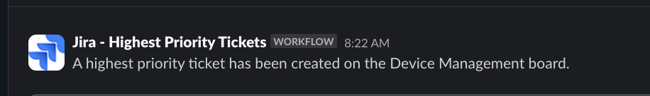

Here is the Slack message:

In the first example, what is the purpose of //returns in the message content? I have not seen that in the examples of Send Slack Message that I have found. If you remove that, what is the result?

Thank you, just fixed that! However, even with that change, it still does not output those fields in the message:

Please provide new images of your rule and the details of the Send Slack Message component.
viraj October 3, 2024
@Trudy Claspill I changed the error you pointed out. See below:

I see that you are using this syntax in the smart values section:
<{{issue.toUrl}}|{{issue.key}}|{{issue.summary}}>
The help text below the Message input field says:
Use this format for links: <the link|your text>. For example, <https://slack.com> or <https://slack.com|Slack>. Learn more about Slack's formatting guide.
I am guessing that you are trying to provide a link in your message because you are using <> and included {{issue.toURL}}|
However your syntax includes two of the pipe characters (the vertical bar | ), where the example shows only one. I wonder if that could be causing a transformation problem. If you want the message to show the issue key and summary which the entire text of both associated to a link to the issue, try removing the second pipe character in your syntax.
Again, I note that I don't have an environment in which to test messages sent to Slack. I am basing my suggestions on documentation that is available on the internet and my own deductive reasoning.
