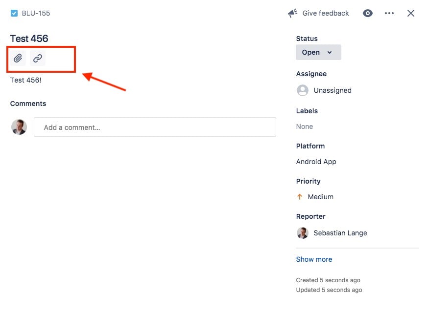

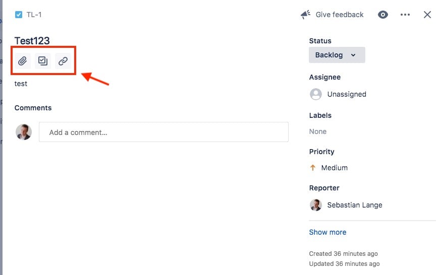

We're using JIRA Cloud and we really like the new UI. On a Kanban board of one of our projects there're the Quick-add buttons (as explained in the documentation) for attachments, subtasks, and link issues:
But in another project the one button for creating subtasks is missing:
The project configurations are not equal but quite similar. We looked at board configurations, issue type schemes, etc. but we couldn't find a setting for this.
Any idea how to get the sub-task button back?

Sebastian Lange
January 2, 2018
Ok , I found the problem! :)
If you have a custom field that is set as Required the button disappears. In my case we have a mandatory "platform" field where you have to set the correct target platform for a subtask.
