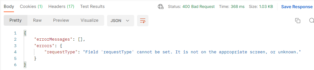

Dear Atlassian community,
I would like to ask you if there is a way to set the CRT of an issue when creating it via REST API on the Cloud platform. I read some articles but none of them were helpful. From my testing, all I get is:
I tried with ID, I tried with name but I get the same result. The field is included in the create issue screen. I would be very happy if you could give me some advice :)

Hey Dirk,
Thank you very much for the fast response. Everything looks nicely explained but I just have trouble with this API call:
rest/servicedesk/1/servicedesk/request/ISSUE_ID/request-types
I put it as it is but I also tried with the service desk portal id, issue key and so on. I did not have success - I get the 404 error.
Is it possible to explain it in a bit more detailed manner? I would be very thankful :)

Hey @Nadezhda Hristova ,
to use that endpoint you need to use the issueID and not the issue key.
In the related Cloud issue (https://jira.atlassian.com/browse/JSDCLOUD-4917) it is actually mentioned by one of the comments.
Note that's it'sissue id(eg. 123456) and notissue key(eg. SDA-123) - might be why you're getting 404.
When requesting that endpoint, the value of the customfield is the combination ofportalKeyandkeyfor the customer request type that you want:portalKey/key. So in the example given in the workaround articles, the response tohttps://YOUR_HOSTNAME/rest/servicedesk/1/servicedesk/request/ISSUE_ID/request-typeswould have been something like:
  { "validRequestTypes": [
        "id": 123,
        "cvId": 12,
        "portalKey": "sda",
        "portalId": 10,
        "key": "getithelp",
And therefore the value would besda/getithelp
You can find an issue id by requesting /rest/api/3/issue/<issue-key>.
https://jira.atlassian.com/browse/JSDCLOUD-4917?focusedCommentId=2490016&page=com.atlassian.jira.plugin.system.issuetabpanels%3Acomment-tabpanel#comment-2490016
So you'll first have to call the /rest/api/3/issue/<issue-key> endpoint to get the issue key and then use the issueid to go on to the next step
Nadezhda Hristova
August 31, 2022
I got it the right way this time. Thank you, Dirk!
