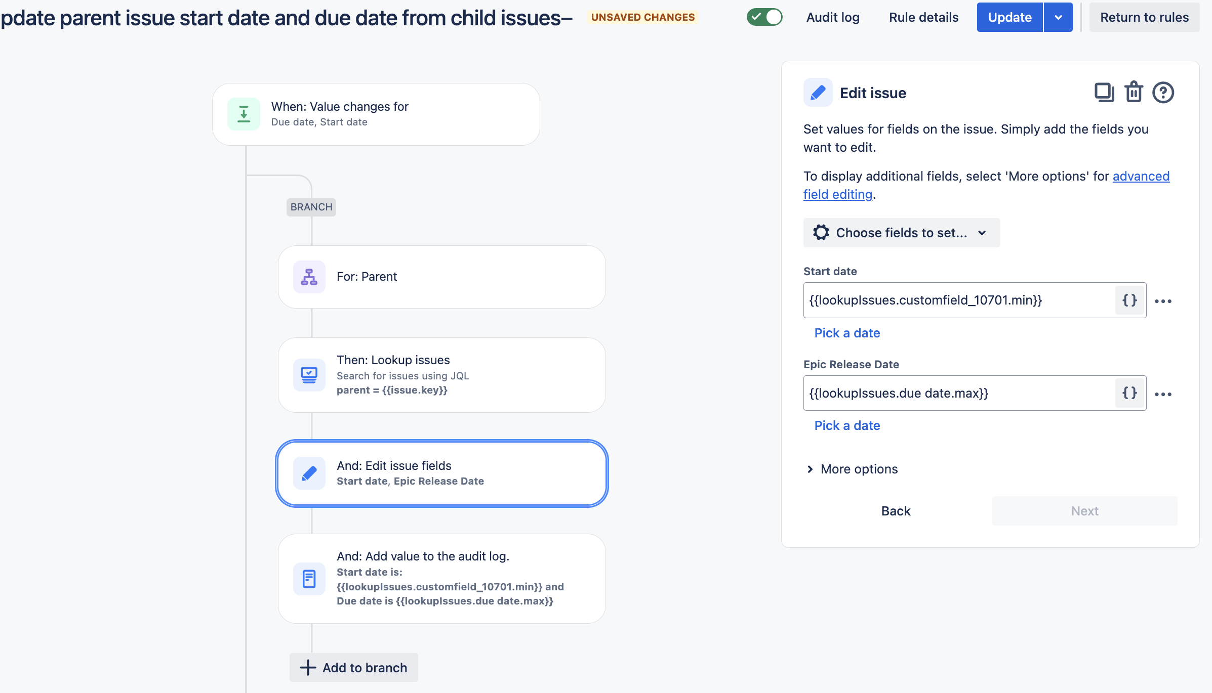

How to write an automation in jira such that If a story’s start date is updated, the automation should update Epic’s start date to the earliest start date of all the stories linked to the Epic. Additionally, if a story is removed from an Epic, the automation should update the Epic’s start date based on the remaining stories linked to the Epic.
I managed to write an automation (and it is working as expected) for the linked stories but could not write a logic for when a story is removed from an Epic. Kindly help.

For the case where an issue is removed from an Epic you would need to start with the Field Value Changed trigger and monitor the Parent field.
With that trigger you get access to the {{fieldChange}} smart value, which allows you to access the value of the field before it was change and the new value of the field. Refer to:
https://support.atlassian.com/cloud-automation/docs/jira-smart-values-issues/#--fieldChange--
Using those values you can create a FOR JQL branch to change focus to the previous Parent Epic and execute the steps to change its start date.
You can also use the steps you have in your first rule to update the start date for the trigger issue's new Parent Epic.

I recommend this structure.
Branch 1 handles the scenario where an issue has been added to an Epic. If the issue has been simply removed from an Epic then Branch 1 will be skipped.
Condition 2 evaluates if the issue was previously associated to an Epic. If it was, then the subsequent branch will handle updating the issue's previous parent Epic. If it was not previously associated with an Epic, then the subsequent branch is not executed.
I don't believe you need to condition to compare toString and fromString. If they are not different, then there has been no change to the Parent field and the rule would not have triggered.
