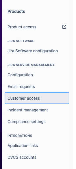

What settings do you have forr Customer Access in the System > Products > Customer Access settings?

Here the settings on customer access
The customer is visible in the list of IT project, but doesn't seem te be connected. (screenshot with privacy marks) When I type @emailaddress of the SebGmail in a issuecomment it doesn't arrive in the inbox.
