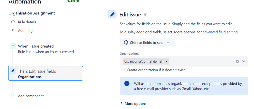

Not 100% sure if this solves your use-case, but you can just setup a rule like this to set the org based on a reporter's e-mail domain:

Michael Strong
June 30, 2022
Sadly, this doesn't work on our project for some reason...

To break down the issue bit by bit, I've already created the automation you outlined before, as follows:
But when I create a new issue from the portal, despite the issue successfully passing through the automation, it doesn't assign the issue to the organization. The organization below should be "ITW Construction Products", as that's the organization that it's apart of.
The only way the issue gets assigned to the proper organization, is if the customer chooses to share the issue with their organization.
So in my mind, either I'm missing something in terms of the Organization field, or in terms of the forms that I'm getting people to sign. Maybe there's a way to change the default value to the "Share with" option to "share with organization", and have it hidden?

Hi @Michael Strong
Is the reporter´s user already member of an organization? What kind of domain is it that you tested with? --> the rule won´t work for free mail-providers like gmail, etc.
I tested this kind of rule on my side and it worked:
testUser has an email with a private domain and is a customer in the organization "test_SAS". I created the request via customer portal setting the setting to "share with no one". After the creation the organization was set automatically --> see screenshot

I'm using a test email to see if it works. The test email is a yahoo email, my personal email in fact, with it being @Sky.com. Guessing that wouldn't work though.
Stefan Salzl
June 30, 2022
Guess that won‘t work either. Any option of testing this with a company email?
