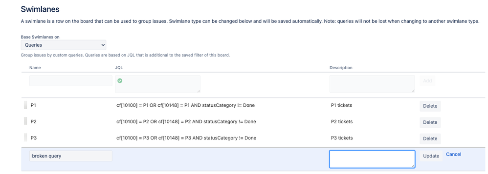

I think there has been a glitch while adding the queries in my swimlane.
Essentially, I'm not able to remove one query. The delete button is missing, and it's creating a lot of confusion within the team.
Is someone able to help me?
The test query is the unwanted one.

Hi @Antonio Carvetta are you referring to a quick filter?
Antonio Carvetta
May 23, 2023
Yes. @Craig Nodwell
This is happening because you must have a swinlane that shows the rest of the issues that are not tied to the swinlanes.
So you need to create an empty swimlane, it will reflect the "Everything else" needed.

Hey Antonio,
Can you share some more details? Maybe some screenshots? What type of project is this?

Hi @John Funk , just attached the screenshot. It's a kanban board we use to monitor support tickets.
John Funk
May 23, 2023
Okay, thanks. It looks like you are trying to rename the default swimlane. You cannot delete that if that's what you are trying to do. There must always be a swimlane that will catch all issues that pass through the other swimlanes based on your board filter. Otherwise, there would be the possibility that issues would disappear from the board based on them not meeting any swimlane criteria, and that is not allowed.
