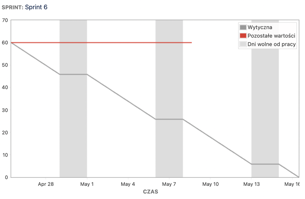

I've got a problem with my sprint burdonw chart. The team has been working on this project for several sprints now and there has never been such a situation. Although the story points are burned, the chart does not respond to changes ( attachment). Can anyone have an idea what the causes could be? I'd appreciate your suggestions.

Are your issues being marked as "done"? That is, in the last column of the board?
Hi @Nic Brough -Adaptavist- yes, issues are marked as done and this status is in the last column.
Are the issues base-level issues (not sub-task types)? And are all their sub-tasks (if they have them) in the last column too?
@Nic Brough -Adaptavist- Each type of issues are marked as Done - status from the column on the far left.
Um, that's the wrong end of the board, as I said, your Done status needs to be in the last column, not the first.
Hi @Ola Czyż - Has there been any recent changes to workflow and/or board column config? The burndown is based upon issues in the far right column.
Hi @Mark Segall , thanks for the answer! I've already check this, as I know this could be an issue, but no, there were no changes within workflow or column board.
Have you verified that the completed issues also have a resolved date and resolution?
@Mark Segall yes, they have.Estimation of the story points was changed during the sprint. I am wondering, if this could affect?
That shouldn't impact. I just verified in my test environment that I can change story points after sprint start and still get a burndown.
