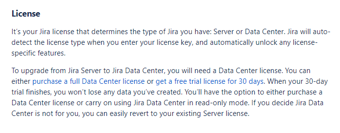

From a license perspertive, the difference is only the price and subscription model that differ. If your jira version is recent you can purchase a Data Center license for JIRA and all the app. Using DC license on your existing Server (non-clustered) setup will work.
See difference between DC and Server below.
You should change the jira architecture to deploy a cluster at some point to benefits all JIRA DC features.
https://confluence.atlassian.com/adminjiraserver/installing-jira-data-center-938846870.html
The process is almost identical to an ordinary Jira Server installation, just be sure to enter your Data Center license.
Regards
Thanks a lot, My jira software version is 9.5.0, can I buy a license for it?
and if I understand correctly, the only difference on the license key, means, if I change the License in all things I have I switch to the data center version, am I right? Is it really as simple as I thought? :)
Yes,
Application license and all app licenses have to use DC license. You can try in a test env to replace all your license with DC license (trial) if you want to be sure.
At some point I recommand to set up a cluster to benefits all Data Center feature.
Regards
