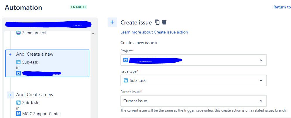

Keith Jones
October 10, 2023
Do you have Parent Issue set as "Current Issue"? in your subtask step?

Hi @Corey_vinnedge -- Welcome to the Atlassian Community!
For a question like this, please post an image of your complete rule, images of any relevant actions, and an image of the audit log details showing the rule execution.  Those may provide context to explain the symptoms you are observing.  Thanks!
Without seeing those...
I wonder if this is either a branching or timing problem in the rule.  A typical rule to do what you ask is:
  • trigger: scheduled, with no JQL
  • action: create an issue (e.g., story or task)
  • branch: on most recently created issue
    • action: create sub-tasks (adding as many as needed in one step)
How does this compare to your rule?
