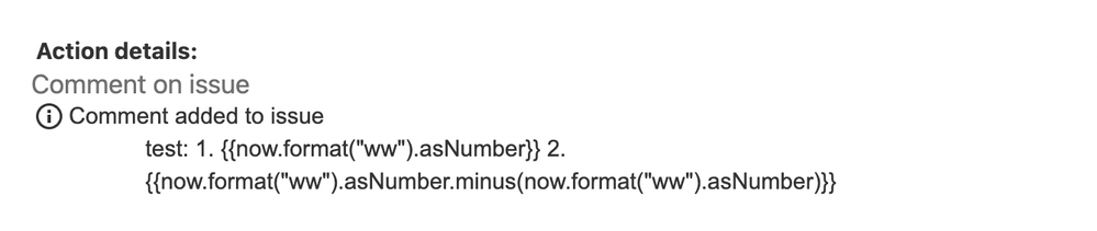

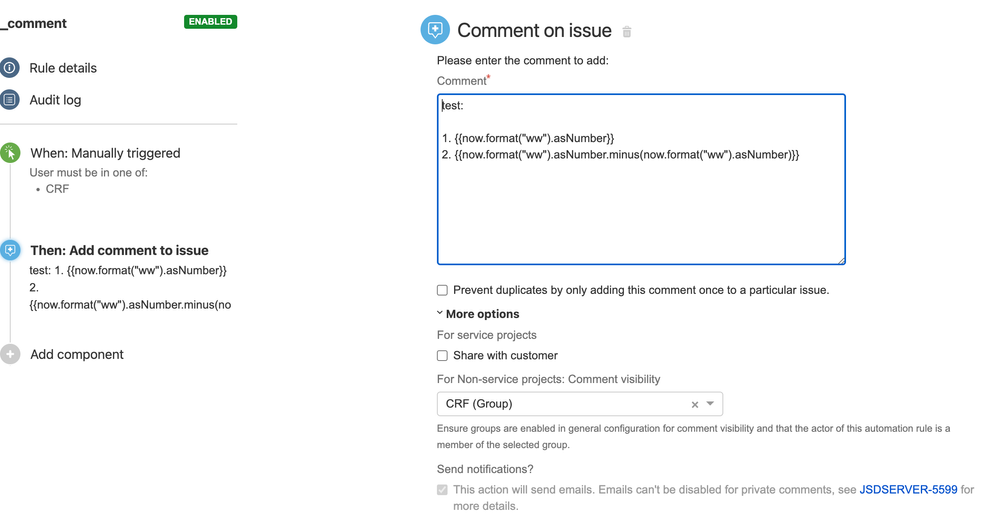

There's not much in it actually since I created a test automation to test the expressions. The audit logs states succesfull but in reality the expressions are ignored resulting in blank input

I am using Jira Cloud, I repeated your exact rule write to the comment and it worked for me...again.
Rules can get "glitched" with too many edits; I have no idea why this is, and...
We can check if that is the cause by trying this:
  1. Disable your rule, re-enable it, and test again.  If that does not help...
  2. Disable your rule, and re-created it as a new rule, and test again.  If that does not help...
  3. It appears there is something different with your install or with Jira Server.
At that point, I'd recommend working with your site admin to contact Atlassian Support.  They may see something we are missing, or perhaps can explain if there is a difference for Server versus Cloud in the format() function.
