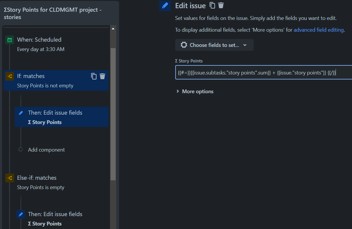

Now sub-tasks is easy. We are able to leverage the subtask smart values and pull out the story points, we then just have to sum them up and Hey presto. However, you have to take into consideration if the main story also has story points. So using conditions you can separate out what the actual sums are. I created a new custom field in order to story the story point of the actual ticket plus the roll up value.
If you want the JSON files you can email me.

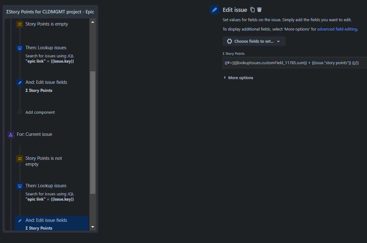

Okay so we now have a sum for the stories itself. how do we now go up to Epics and beyond? For Epics, we now can leverage the epic link field. Using the same trigger (schedule) update the JQL for the schedule and set it to look at Epics.
Now we need an additional step in order to make sure we look up the issues attached to the epic. But again (depending on how well trained your users are) you may need to factor in story points placed on epic issues. for this we use branches to factor in user experience and to be able to iterate of every current issue, then the lookup action using a smart variable to find where the epic link of all issues matches that of the specific key. On the edit screen we want to make sure we now look up the new custom field since this would be potentially different from the story points on the issue itself.
As you can see from the screenshot above. We use a similar structure to handle the different circumstances, look up the values and then edit the custom field with the lookedup values.

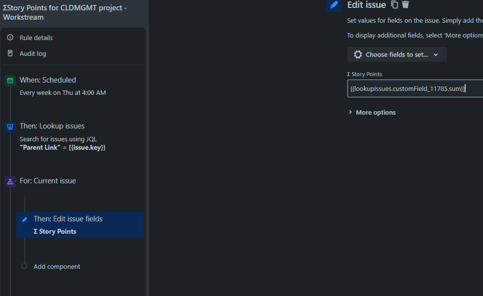

Great so we now have summed up epics. But how do you take this further up a chain if you use it? Luckily there is very little to change in these rules. For every additional level you want to use a copy of this rule. change the issue type we are aiming for (initiative, project etc.), then where it does the lookup actions, change the JQL from "epic link" to "parent link". then just a simple edit action to update the issues custom field from the lookedup values. Then you are done.
These rules, have enabled our team to calculate story point estimates from multiple dev teams from the smallest section to the largest initiative. If you have any questions let me know.
