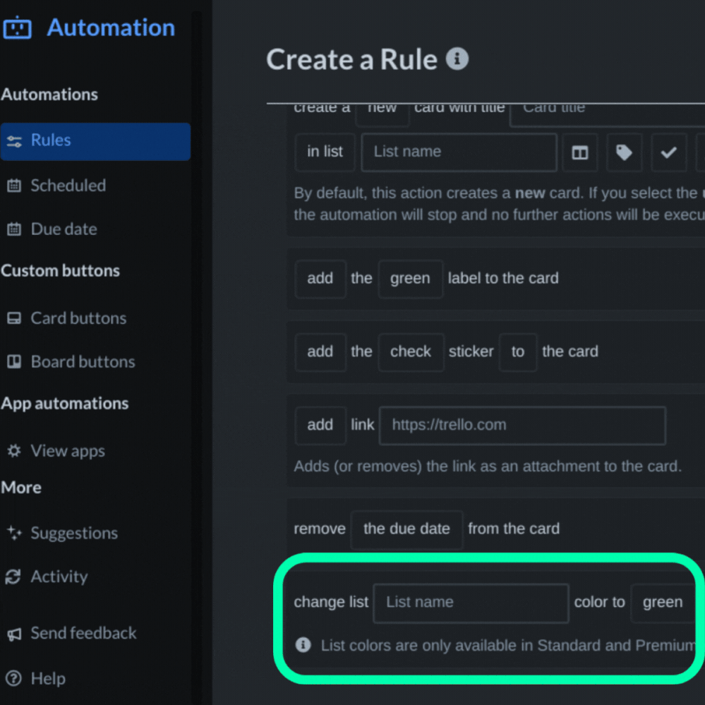

Hi @outfinder @Rembrandt Happel ,
I had prepared an advanced automation guide to do this using the Trello API.
However, Trello have made it a whole lot easier.  This is now built into Trello automation...

Regarding what you want to do.  You should be able to change the list colour based on a card on another board, so long as the card is linked to a card in the list that you want to change.  Something like:
When a card is marked as complete, find the first card linked in attachments and set the list color to Green

Mike - Dreamsuite Consulting
March 24, 2024
Collapsing lists happens as a browser action so no but you can automate the list colour with an automation http set...
I will write a guide for this tomorrow and link to it
