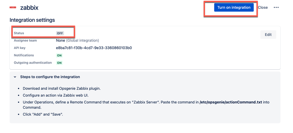

John M
May 30, 2024
Hi @Nikita Egorov ,
Are you certain the integration itself is disabled, and not just the notifications?
If the integration is disabled you will see this:

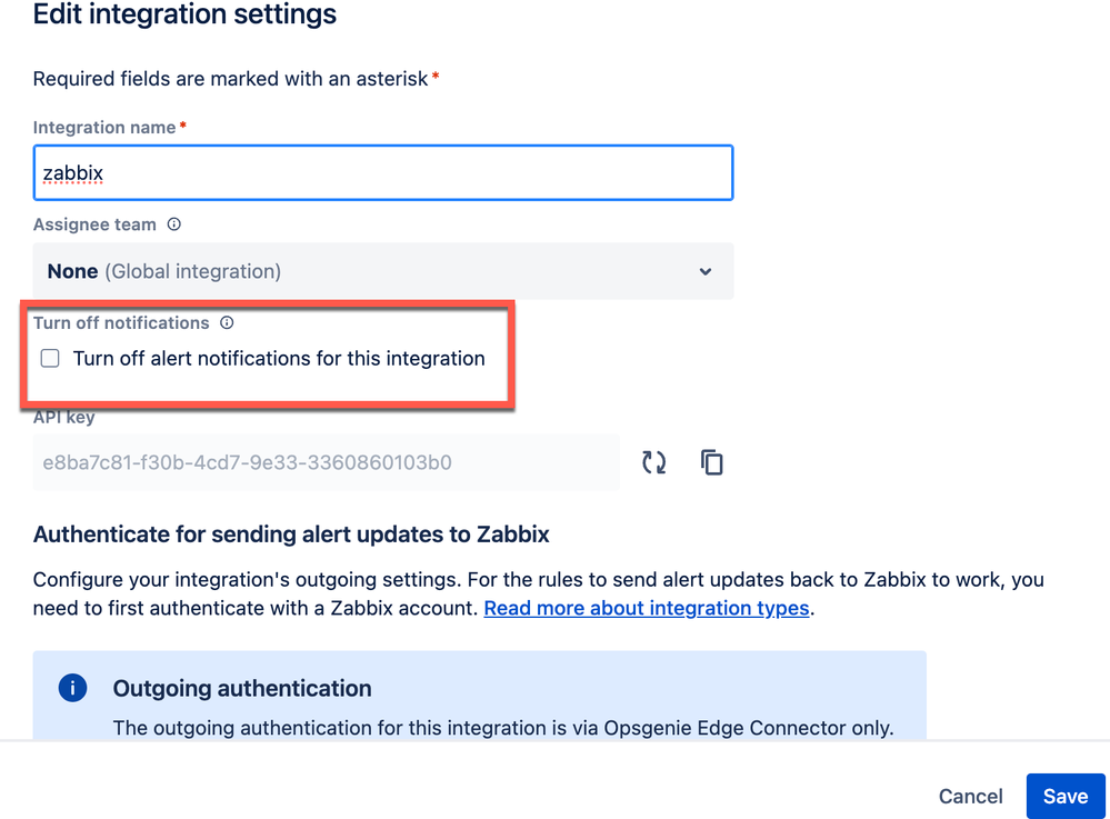

However, there is a separate option to just disable the notifications:
Additionally, have you verified that the API key in your Zabbix instance is the same one from the disabled Zabbix integration?
If you've checked both of those things, please open a ticket here so our support team can look into it - thanks!
