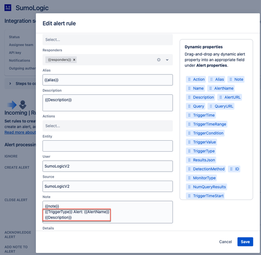

For example, if you need the alert message and description to be added as a new entry in the Note field each time there is a deduplication, you would do the following:
  1. Edit the Create Alert rule of the integration in question
  2. Copy the configurations from the Message field and the Description field and paste them into the Note field and save the Create Alert rule.
  3. Shown below is an example screenshot for the Create Alert rule of the Sumo Logic integration:
What this will do is that each time the Create Alert rule is triggered, all the information that is parsed for the Message and Description fields will get added to the Note field.  This will happen during alert creation as well as alert deduplication.

I notice you left the {{note}} within the field. Is that required?
