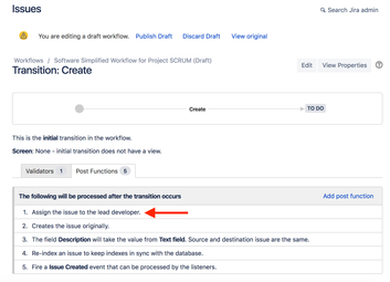

1 - Check if there's a post-function configured to set the Project Lead as the assignee
   - Navigate to the project where you are creating your issues > Project settings > Workflows > Click to edit the workflow related to the issue type you are facing the problem
  - On Diagram mode, Click in the create transition > Post functions > Check if there are any post functions that would automatically set the assignee field:

hi, thanks for the reply. i have checked the issues above but that didn't directly helped me - but have realised it has something to do with the post function.... at the end we ended by creating a workflow only for the migrated defects so that the Assignee will not be replaced with the component lead (we will migrate to a special project and then move it to the correct project)
