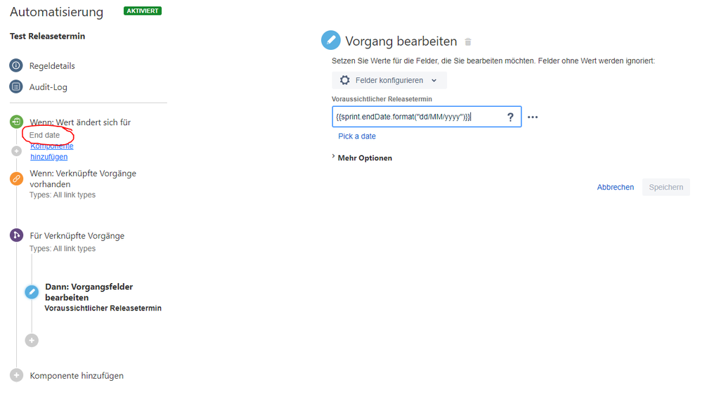

Lars Blaschka
May 12, 2020
Hi @Mohamed Benziane ,
I am not quite sure if I do this correct... I just dont know how to set the automation up.
Right now I have set that if the field "end date" of a linked issue is changed, then the value "expected release date" of the issue in serviceDesk shall be updated by "{{sprint.endDate.format("dd/MM/yyyy")}}" but nothing happens. I think because the field end date is not enabled in my project / issue screen. And I am not sure if the field end date is the same as the end date of the sprint.
It drives me crazy.... Do you have an idea?
Cheers, Lars

Lars Blaschka
May 13, 2020
Hi @Mohamed Benziane , sure, here is the automation. I am sure that the mistake is the field "end date". It is not the field I need to add....
What I really need is the field in the second picture. The end date of the active sprint a linked issue is added to. You can see it in the backlog below the name of the current active sprint. Its called sprint end date, but i cannot choose it in the automation...

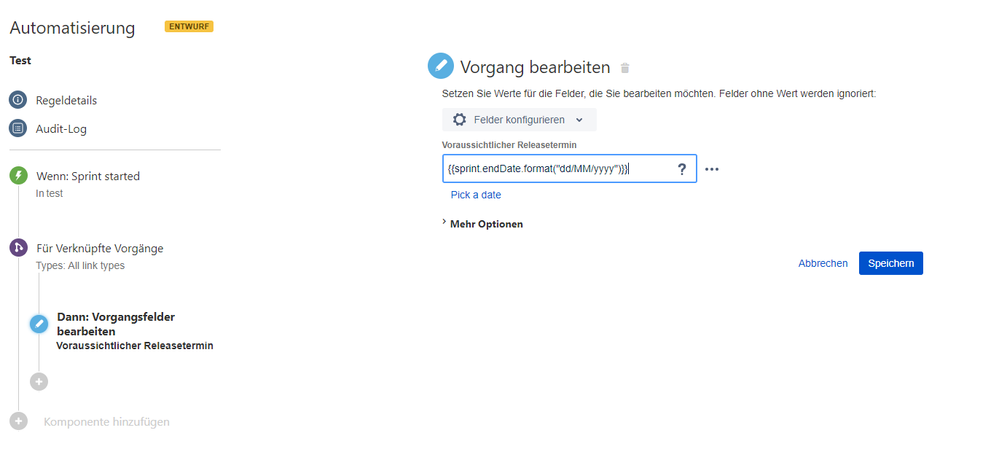

Lars Blaschka
May 13, 2020
Okay, thats an interesting hint.
Do you think the automation could work like this (screen attached)?

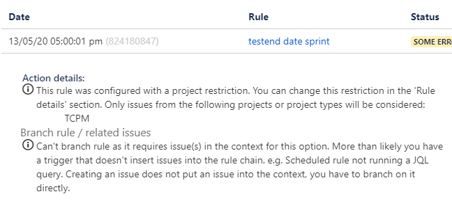

Mohamed Benziane
May 13, 2020
i just tried your rule (For "Linked issues") and it doesn't work
