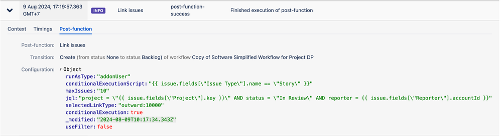

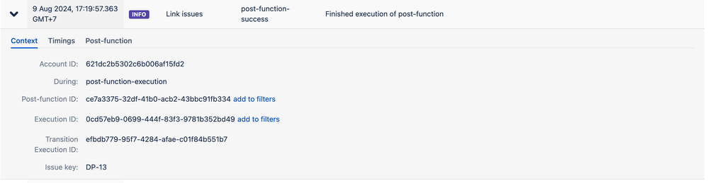

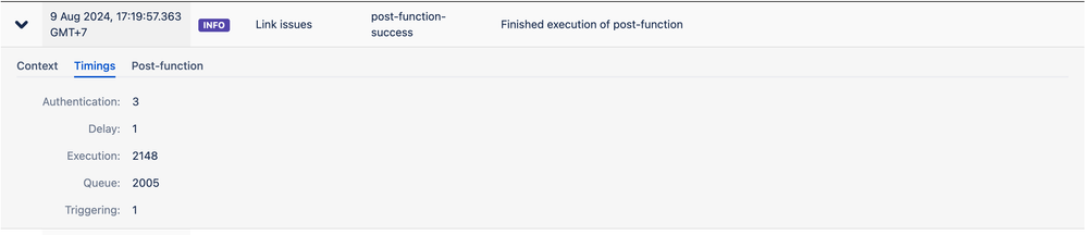

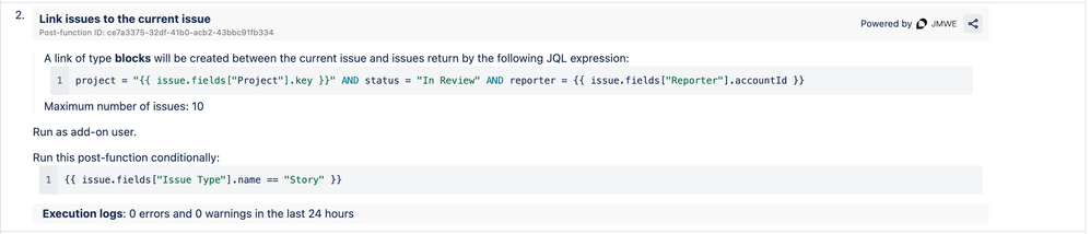

i want to ask that i want to set the post function to linked issue that match the jql that i wrote like thisScreenshot 2024-08-09 at 17.37.51.png
but when i check there is no error and the log is look like thisScreenshot 2024-08-09 at 17.38.58.pngScreenshot 2024-08-09 at 17.39.04.pngScreenshot 2024-08-09 at 17.39.09.png
what is actually happened guys? and how to fix it?
Thankyou
Regards,
Nico

the first thing I can see is that you're using issue.fields["Reporter"].accountId. I would replace that with:
issue.fields.reporter._accountId
Explanation:
- using "reporter" instead of "Reporter" guarantees that this will work even if your Jira base language is not English
- using _accountId removes the "accountId:" prefix that is automatically added to the "accountId" field

Marc -Devoteam-
August 9, 2024
HI @Nicolas Andika
I only see and INFO post no error.
It even stats post-function success.
Where is the error?

Hi @Nicolas Andika
It might be that your conditional is wrong.
Could you try: {{ issue.fields.issuetype.name == "Story" }}
