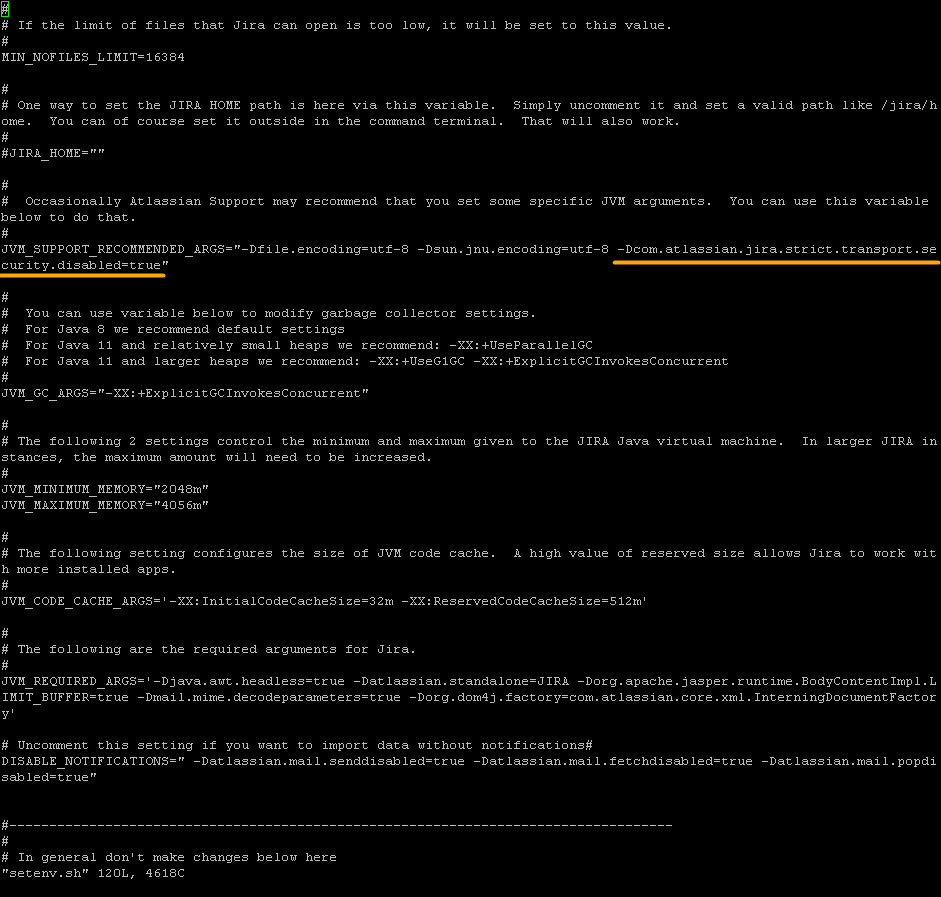

We have add it to setenv.sh into JVM_SUPPORT_RECOMMENDED_ARGS but it didn't help.

It's not really supposed to be used in there, try adding it to the standard environment.
If it's not working, then you'll need to show us exactly what you've put into setenv.sh so we can debug it.

Also, here's the screenshot of current setenv.sh file:2023-02-27_12-53-29.png
