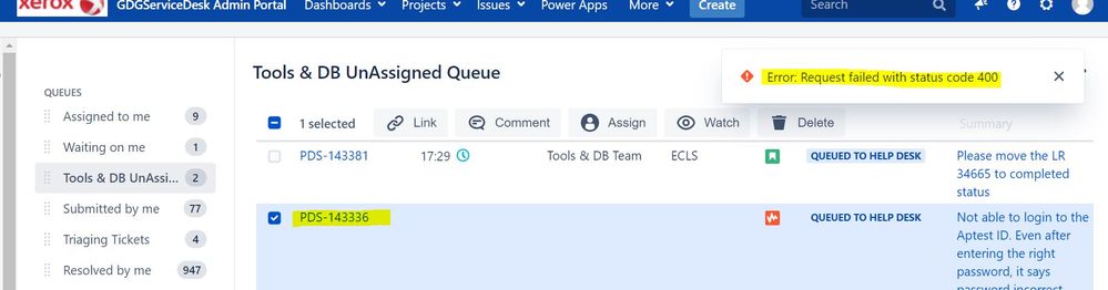

while deleting issue got Error: Request failed with status code 400
Jeya
July 28, 2021
while doing upgradation user created ticket, we are unable to delete that ticket, assign. but it is still showing up in the queue.

Jeya
July 28, 2021
I have admin Permission. please check the screen shot

Okay, thanks for the info, error 400 suggests " response status code indicates that the server cannot or will not process the request " have you tried moving it to another status and then deleting it?
BR, Olga
Jeya
July 29, 2021
it is showing the issue doesn't exist, so we couldn't do anything.
Planning for full-reindex.

If it's showing the issue doesn't exist the re-index should fix the problem, but you can just re-index the project and do a background re-index so you don't compromise any data and people can work normally during re-index.

Jeya
August 3, 2021
Hi All,
Project re-index helped removing that issue.
