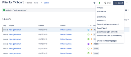

1 - Use the CSV export feature. Steps:
- Create a JQL filter returning all your Next-gen project issues
-  Export your Next-gen issues to a CSV file:
- Import the CSV file to Smartsheets, as described in the documentation below:
Import Files to Create New Sheets
2 - Use a third-party app to import your next-gen issues to Smart Sheets, like:
Smartsheet for Jira
Smartsheet for Jira Connector
Let us know if you have any questions.
