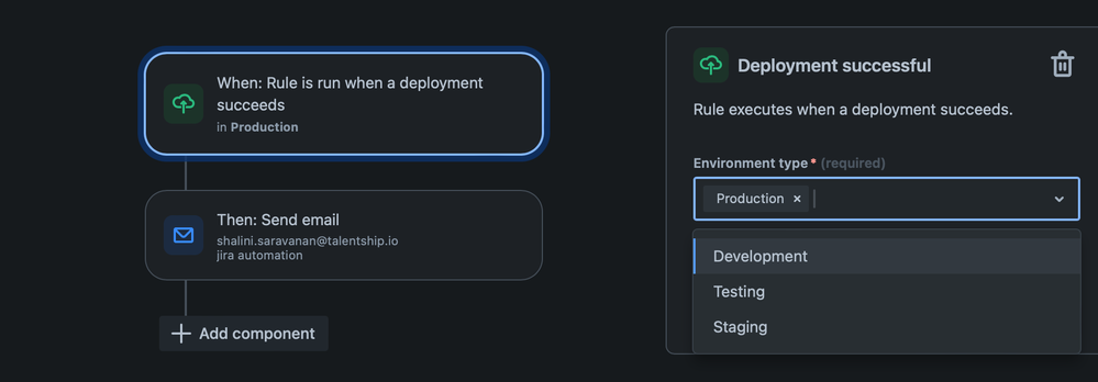

We have recently migrated GitHub repo to new one, integrated repo with JIRA, now the automation we had for when deployment succeeded to production environment is not running in the repo.
Repo is integrated, also PR and branch names are showing in JIRA ticket as expected, but when the PR is merged to branch "production" the automation is not running, where to check for the environment is coded? Is it possible to change the branch name as "main" for production deployment?

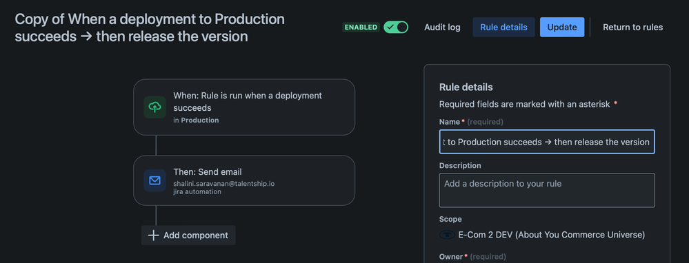

Screenshot 2024-07-27 at 10.21.02 AM.pngScreenshot 2024-07-27 at 10.22.19 AM.pngScreenshot 2024-07-27 at 10.23.36 AM.pngHere is the workflow, when code changes pushed to production branch in newly integrated GitHub but the automation isn't running, what updates needed for the workflow to run when code deployed in prod? and where the environment is coded

Here is the workflow, when code changes pushed to production branch in newly integrated GitHub but the automation isn't running, what updates needed for the workflow to run when code deployed in prod? and where the environment is coded?

When you ask for help with an Automation rule not doing what you expect or intend there are two things you should provide that will help us help you.
1. Provide screen images showing the entire rule and the details from the Rule Details page and for each step in the rule.

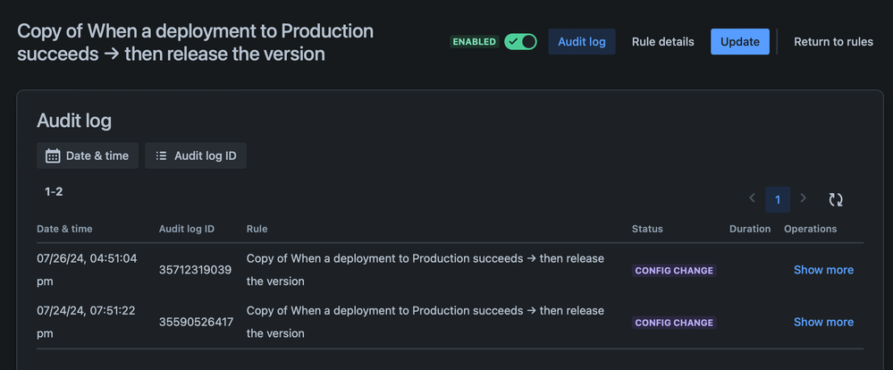

2. The details from the last execution of the rule after you made an issue update that should've triggered the rule. If the rule was triggered the Audit Log for the rule execution could contain details that help debug the problem.

Based on the Audit log information the rule is not being triggered. That means that Jira is not recognizing that a deployment has occurred, or it is not recognizing that the deployment was successful, or it doesn't think the deployment has occurred in the specified environment.

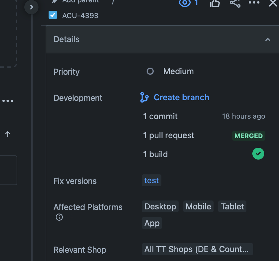

Are the Deployments showing in the Development Tools panel in the issues? Note that deployments are separate from commits, pull requests, and merges.

We dont have GitHub action that sends data to jira as deployment succeeded. As I mentioned earlier we had GitHub repo earlier and imported to new repo recently integrated the repo(even with the old repo we dint have any action created but the deployment succeeded worked fine), branch and pull request are showing here and even the build.
But when the PR is merged with production branch we dont see the above action running. so where the environment is actually coded? apart from GitHub action how to make JIRA recognise the deployment?

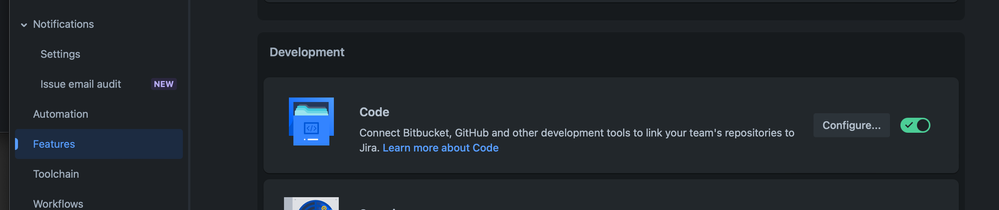

Here is where the GitHub is integrated.
And in GitHub apps JIRA Integration can be seen
