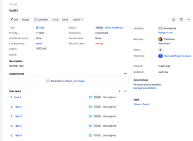

Analyzing the scenario you described so far, I believe the best approach would be to create 1 issue per country as you mentioned since you are going to release the global requirement in several languages and their progress also will be registered in separated contexts.
However, I think that you can use sub-tasks to better organize this matter since the global requirements are the same for the  6 countries. Better explaining, I would create a general task describing the requirement in a general language (Maybe English) and then 5 sub-tasks under that task, describing the same requirement in different languages for each country.
Performing the steps above, you will be able to see the progress of the 6 countries viewing only the general story and navigating through the sub-tasks on the issue view:
Let me know if this approach makes sense to you, Sandeep.
