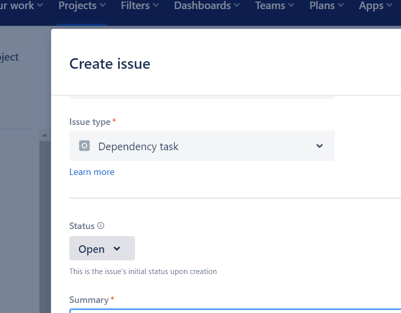

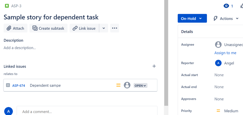

Yes, the custom issue type name is "Dependent task." so here
The Automation should be- when the dependent task is completed, then only my current task should be moved to on hold to On-track.
So once the dependent task - ASP- 674 is completed, then my current task should move to on hold to - on track automatically.
Trudy P Claspill
April 21, 2023
Do you have situations where your "current task" has more than one linked Dependency Task?
Are Dependency Tasks ever linked to other issue using the "relates to" relationship where the other issue is not actually dependent on the Dependency Task?
