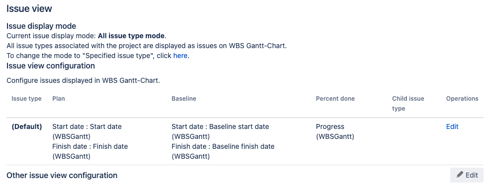

For that, in WBS Gantt-Chart you can still use the Quick Filters, which is a feature that will help you to filter your issues in the Gantt chart  after it was loaded. In other words, the usage of the quick filters you made on your workaround is pretty much what we would recommend to do.
As for the Start and End dates, you can customize which fields you would like to use on your Gantt chart in the Global Issue Settings (Select Jira settings → Apps from the cog icon on the top-right corner, then go to Issues setting in the WBS Gantt-Chart Section).
To find out more about how to change the fields used by WBS Gantt-Chart, please take a look at our documentation: https://docs.ricksoft-inc.com/wbs-gantt-chart-for-jira-cloud/global-issue-settings#GlobalIssuesettings-Howtochangetheganttdatafield

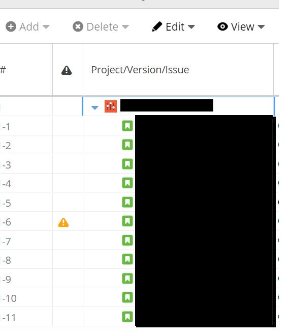

In the filter you can see that i select the epic links , belonging story tickets listed.
I would like to list stories under epic where you can expand. Here in the below picture you can see all Story tickets listed as one list without Epic parent category .
project = projectname AND "Epic Link" = vrt-353 OR "Epic Link" = vrt-366
-Work around
The work around i found , instead of creating the gantt based on filter , i created basedo on project and under gantt configuration i add quick filter with Epics then  i go to Filter and enable the filter then i can see the epics and belonging stories as i wanted.

your query
will only return the stories of epics because the result must match all conditions. Epics don't contain epics inks, only their children do.
if you want just the epics and their children, assuming the epics are in the sam project, try
project = projectname and (issuetype = Epic OR "Epic Link" is not empty)
Re Dates, use the Gantt configuration menu to align dates used with your issue dates. WBSGantt uses its own internal date field by default to avoid unwanted side effects on other functionality.

 " Dates, use the Gantt configuration menu to align dates used with your issue dates. WBSGantt uses its own internal date field by default to avoid unwanted side effects on other functionality. " Any idea how i can solve this sync issue ?

thanks  a lot @Alessandro Portela Cristiano  i will try that solution about date.
