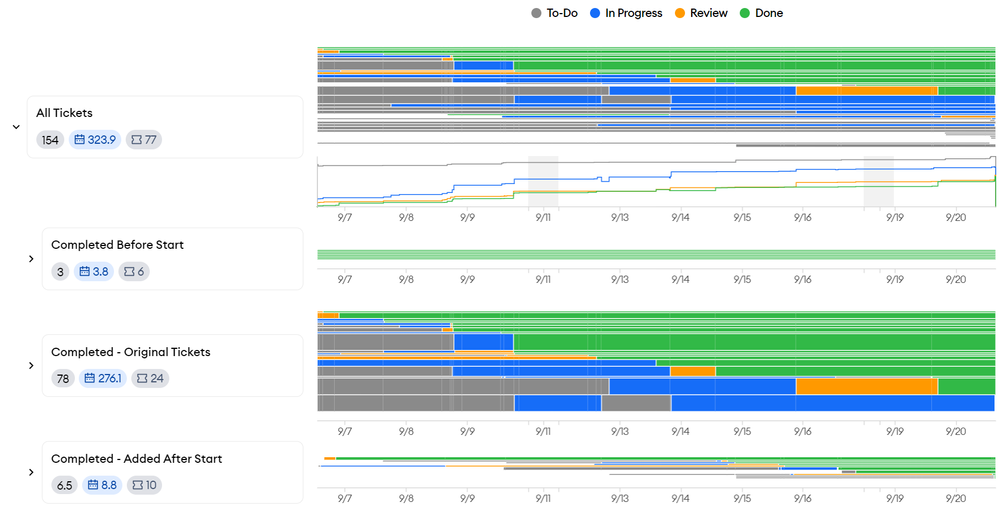

I see that you figured out the answer to you question but if you are interested in analyzing work that was added after the start of a sprint and open to marketplace partners I would like to invite you to check out minware.
You can see the burn up chart below that clearly shows the impact tickets added or removed from the start had on work-in-progress and you would simply expand the "Completed - Added After Start" to dig in:
We try to make things as simple as possible so anyone on your team can understand how ticket flow impacts WIP.
Good luck finding what you are looking for, I hope this helps!
