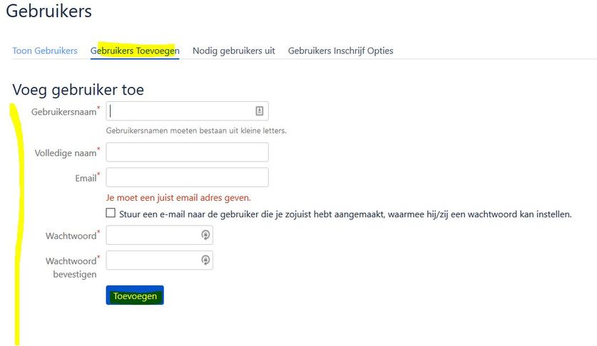

Hello,
I have confluence and Jira installed on a server, but when I want to add a user into confluence, I get this error:
Oops - an error has occurred
logoSystem Error
A system error has occurred — our apologies!
For immediate troubleshooting, consult our knowledge base for a solution.
If you would like to receive support from Atlassian's support team, ask your Confluence administrator to create a support issue on Atlassian's support system with the following information:
  1. a description of your problem and what you were doing at the time it occurred
  2. a copy of the error and system information found below
  3. a copy of the application logs (if possible).
Your Confluence administrator can use the support request form to create a support ticket which will include this information.
We will respond as promptly as possible.
Thank you!
Return to site homepage…
Cause
com.atlassian.confluence.core.InsufficientPrivilegeException: User [pieterjan.vanhoutte] does not have the required privileges.

Moses Thomas
August 13, 2018
@Pieter-Jan Vanhoutte  It looks like privilege  issue please check global permission do you  have   the system  administrator permission, if  not then  add your self  and try to  add user again.
