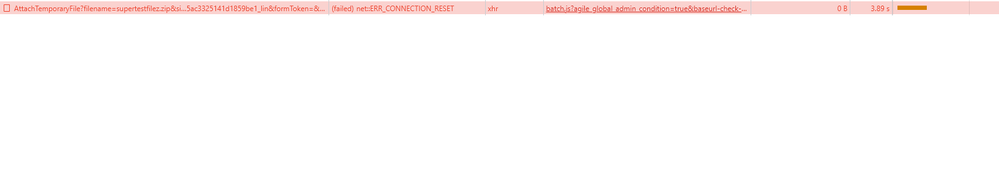

Hello,
we use Jira Server version 8.20.6.
Some files *.pdf or *.asc I'm not able to upload, there is an error message. The file size limit is 100mb. That is not the problem.
I tried to use rest api to upload the files and drag and drop via wegpage nothing works.
I can upload other files without any problem via rest api and webpage.
java.io.IOException: HTTP/1.1 header parser received no byte
Also I get this error on webpage: "File "<nameoffile>" was not uploaded. An internal error has occurred. Please contact your administrator"
I've access to a different jira instance in which I tried to upload one of the  "broken" files, there was no problem at all.
Looking into the server logs I'm not able to see the upload. Where can I see the uploaded files within my server logs? Do I've to activate logging first? Is this a known issue?

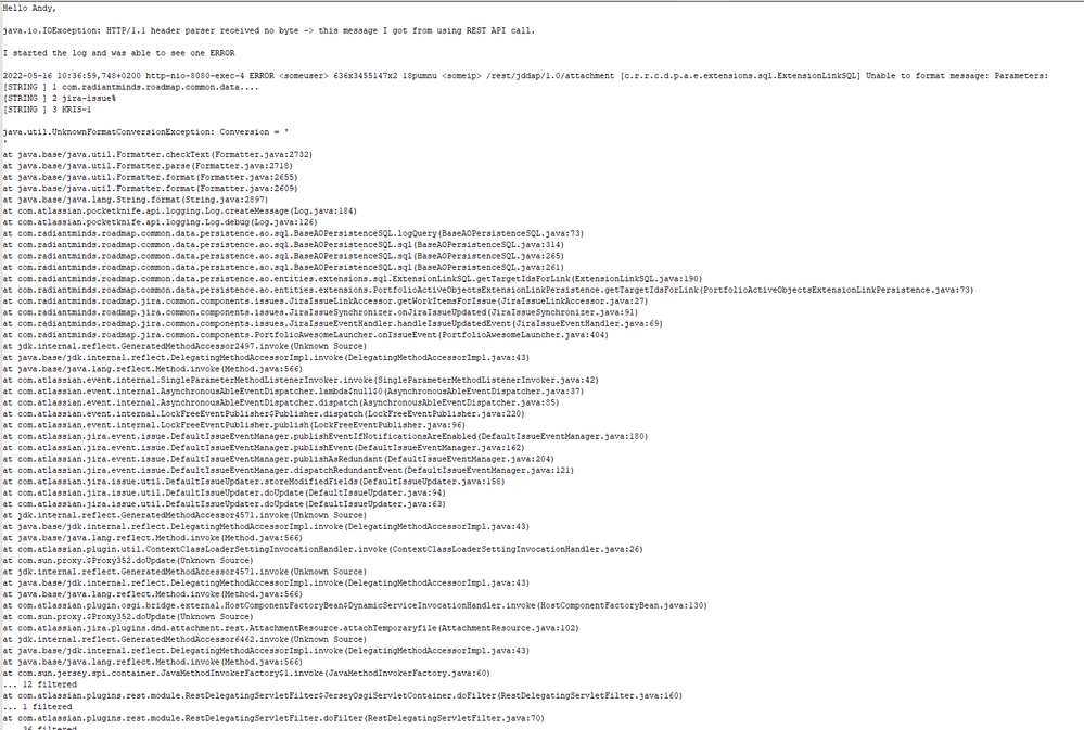

Kristoffer Mc Pherson
May 16, 2022
Hello Andy,
java.io.IOException: HTTP/1.1 header parser received no byte -> this message I got from using REST API call.
I started the log and was able to see one ERROR
2022-05-16 10:36:59,748+0200 http-nio-8080-exec-4 ERROR kmcphers 636x3455147x2 18pumnu <someip> /rest/jddap/1.0/attachment [c.r.r.c.d.p.a.e.extensions.sql.ExtensionLinkSQL] Unable to format message: Parameters:
[STRING ] 1 com.radiantminds.roadmap.common.data....
[STRING ] 2 jira-issue%
[STRING ] 3 KRIS-1
java.util.UnknownFormatConversionException: Conversion = '

2022-05-16 11:01:14,424+0200 ThreadPoolAsyncTaskExecutor::Thread 41 ERROR <testuser> 661x3457209x1 gphsgt 172.16.141.87 /rest/plugins/1.0/com.xpandit.plugins.xray-key [c.x.raven.configuration.RavenConfigurationServiceImpl] Get invalid
thread count, available processors '4', max threads '8', using default '6'
Other errors are not present. Is this a known issue?
May 16, 2022
Hello Andy,
2022-05-16 10:36:59,748+0200 http-nio-8080-exec-4 ERROR <someuser> 636x3455147x2 18pumnu <someip> /rest/jddap/1.0/attachment [c.r.r.c.d.p.a.e.extensions.sql.ExtensionLinkSQL] Unable to format message: Parameters:
[STRING ] 3 KRIS-1
May 16, 2022
Hey Andy,
everytime I post my answer here my answer disappears after refreshing this page... ?
I'll try to add this my image:
hopefully this post will be there shorty after I hit "Reply".

Andy Rusnak
May 16, 2022
Thanks Kristoffer!  Looks like the messages did come through, thank you for the exception message.
So this error message looks potentially to be caused by a special character potentially being inserted into the name of the file.  The 'java.util.UnknownFormatConversionException: Conversion = ''' message usually is thrown when there is a character that the Java backend cannot interpret properly.
Having said that, since you are able to upload these 'broken' files into other instances I do not think it is an issue with the file itself, but rather something specific in this instance of Jira not in others (although it would be helpful to confirm that the file name doesn't include any special characters like % signs for example).

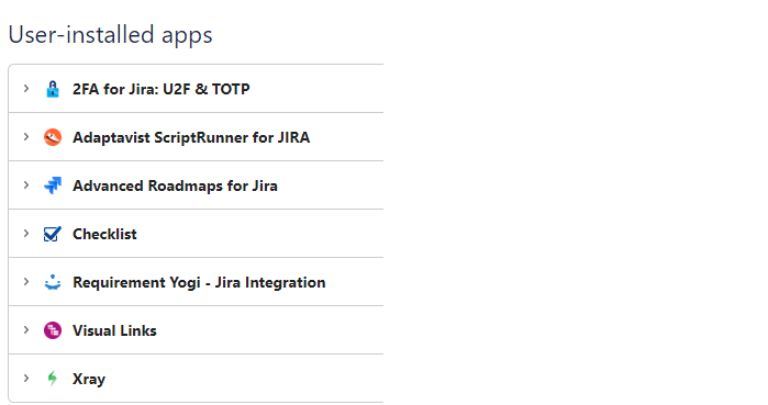

What plugins are are installed on this instance that are not installed on other instances?  Plugins are usually the easiest thing that changes between environments.  You can see what plugins are installed in an instance via Settings Button (gear icon) > Manage Addons.
If we can compare the plugins between environments to see if there are any differences that should be a good place to start here.

Hello Andy,
we change the naming of files to simple numbers like 123.jpg or test.zip, but we still get the same error.
I will attach a screenshot of our Plugins. I tried to disable one after another and tried to upload the file, but hat no luck. So I disable one plugin -> tried to upload a file -> enabled it again and went to the next one. Should I disable all at once?
Do I have to restart the jira instance to make the changes take affect?
Like posted above, there was another error from Xray. I updated all apps to the current version.

Thank you for the screenshot! You will not have to restart after disable plugins for the changes to take effect.
If it is possible, let's try to run this instance in safe mode which will disable all plugins at once.  As you asked about, I think that is a good idea to try next.  The Disabling and Enabling Apps page contains instructions on how to do this (its about half way down the page it talks about safe mode).
Another question that comes to mind while looking through the exception again, where in the application is the issue you are launching when try to attach the file?  For example, are you in Roadmaps and then you launch the issue?  Or are you just at a project board when you launch the issue.
The reason I ask, the exception has some classes that point to roadmap functionality.  So if this issue is in Roadmap and that is where you are launching it from, it might also be a worthwhile test to create a brand new issue that isn't on a Roadmap and try to upload the file there.
But I think the first test is disabling all the plugins at once through safe mode and trying again.  I think it would be worth capturing another set of logs with the plugins disabled as well to see if the exception is the same.

I looked into the Network Tab of my browser and found "AttachTemporaryFile=...." failed, further there is a ERROR -> (failed) net::ERR_CONNECTION_RESET and Size = 0
https://<somejiraURL>/rest/internal/2/AttachTemporaryFile?filename=testfilez.zip&size=43007087&atl_token=BA4C-PGZS-MZA8-24Z6_b4a16b96249a6c554385f35ac3325141d1959be1_lin&formToken=&issueId=1034100
We are working behind F5 Proxy, could there be a problem? If so, why are only certain files blocked?

Thanks for the additional information Kristoffer.  This is very helpful.  I agree with you that it doesn't seem to be the initial exception message we were troubleshooting if we are getting this network reset error.
This message could be related to a few things.  I think where we would probably want to start would be to try to simplify the network topology to help us isolate where the problem might be happening. The message indicates the connection is closing or being reset when attempting to upload the file.
The first thing that comes to mind for me is the F5.  Do we have the ability to bypass the F5 and go directly to a single server for a test connection?  If the issue persists connecting directly to the server then we know the load balancer isn't the root cause.  This is usually the easiest place to start.
Also can we confirm that there is session persistence (also known as sticky sessions or session affinity) configured within the F5?  If the connection is flipping between Jira nodes based on the F5 routing that can certainly cause behavior like this.

thank you for your answer. F5 was blocking files and rest calls with certain strings (log4j) . Therefore the filesize was reduced to zero. Further there was no entry within the logs.
We changed the F5 setting and now everything works. Thank you for your help.
