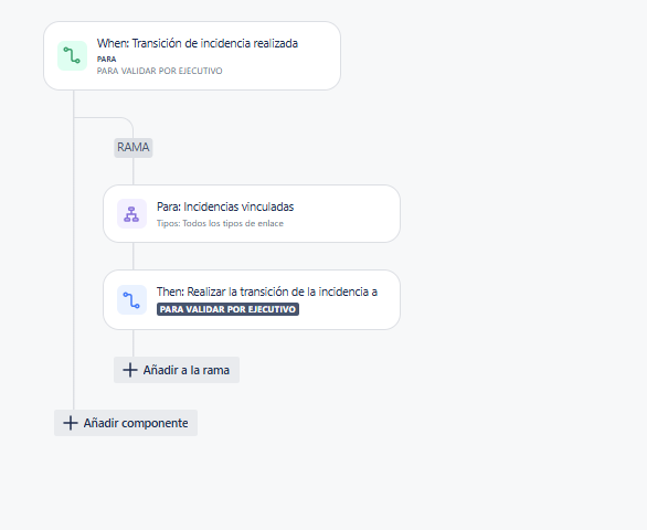

Beatriz
August 30, 2024
In the end I set it up like this.

Beatriz
August 29, 2024
My firs project is type Attendance management
My Second project is type Company managed business
I have the first project with ticket siv-154, this ticket goes to status AA. At that moment, ticket PS-14 is generated  with incident siv-154 linked in the second project. When ticket PS-14 changes to status XX, I want the status of ticket siv-154 to change to ZZ.

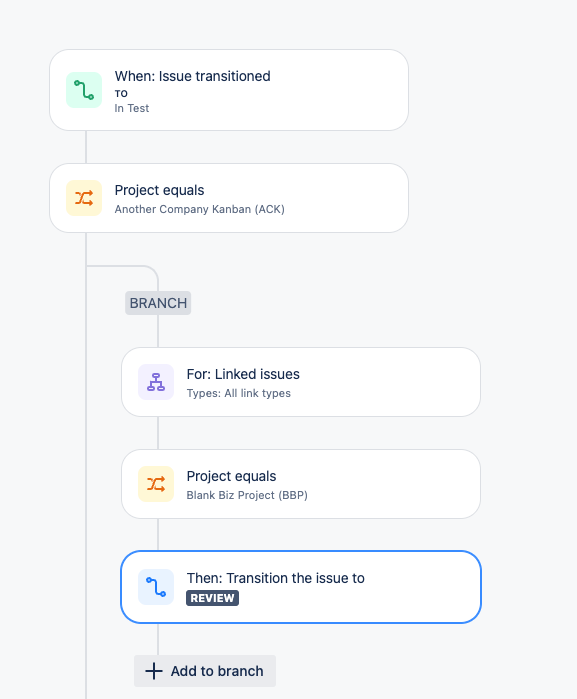

Trudy P Claspill
August 29, 2024
"Attendance Management" is not a project type that I'm familiar with. Can you show us a screen image that shows that Project Type information as it is displayed in the View All Projects screen, please?
You would need to create an Automation Rule that is set to a multiple project scope, where you identify both the SIV and PS projects as in the rule scope.
You would use the Issue Transitioned trigger, specifying the To Status as XX.
You would follow that with a Field Value Condition to check that the Project field equals PS, to ensure that the issue that triggered the rule is the issue in the PS project.
You would follow that with a For Each branch, selecting Related Issues / Linked Issue. In the definition of this branch you can option limit it to looking for issues that are linked with specific link types
Within the branch you would add a Field Value Condition to check the Project of the linked issue and confirm that is the SIV project. For linked issues in any other project no additional action will be executed.
The last step is to add a Transition Issue action in the branch to transition the SIV issue to ZZ.
