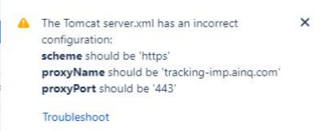

Samia Rahman
April 6, 2022
Hi I am using below documents to integrate aws alb. in the server I am getting attached error. How do I update the server.xml file?
Integrate Jira/Jira Data Center with AWS ELB | Jira | Atlassian Documentation
