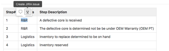

Thank you Jack. I created a Page for Sprint1. created the test cases there in that page. not able to do in tabular format. also not able link the defect. please advise

@Ajish, so we have moved from Jira to Confluence on this question. Generally it is best to open a new question in the associated application so it gets the appropriate eyes. With that said...
in Confluence you should be able to add a table via this icon -
You can add a JIRA issue to the page via two methods. The first is while editing the page click more macros (+) and select JIRA Issue/Filter. This can be done directly in a cell w/in the table.
The second is when in the view mode (not edit) you can highlight text and create a JIRA issue directly from Confluence.
