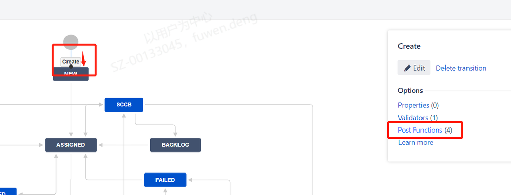

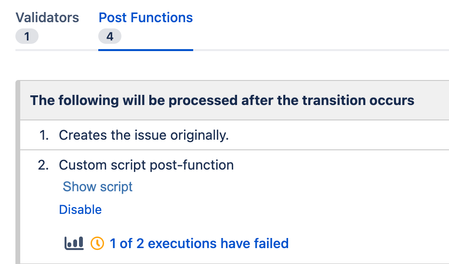

Tuncay Senturk _Snapbytes_
April 14, 2022
Hi @dengfuwen
Sorry for the late response,
I just copied the code and used it in a workflow function and worked as expected.
Then I realized you're using this function while creating the ticket.
Please move down the function below to "Creates the issue originally."
It will be seen as below.

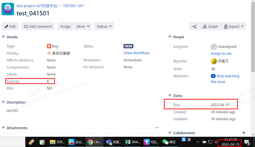

dengfuwen
April 14, 2022
Thanks for the reply,
There is another problem right now, I find that Duedate is wrong, whether "Severity" is set to S or B, Duedate is the creation time.Can the date not be added directly?

Nic Brough -Adaptavist-
April 15, 2022
Your code is only adding 2, 5 or 10 milliseconds to the date/time
For 2 days, try
dateToSet.plusDays(2)
or
dateToSet = dateToSet + 172800000
dengfuwen
April 17, 2022
My problem has been solved, thanks to the two brothers for your help
