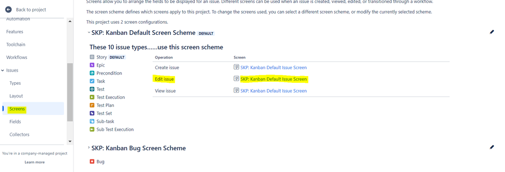

In fact, adding the field to the Screen is the wrong thing to do. When the field is added to the Screen, that makes the Resolution field editable on the Screen. However, one unique thing about the Resolution field is that if it is on a screen and editable then it is required to have a value. The field should only have a value when the issue is in a Done/green status. At all other times the field should be empty. But if the field is editable you are forced to fill it in. You can't leave the field empty.
So as @Jerrold - Empyra suggested you do need to remove the field from the screen so that it will no longer be editable.

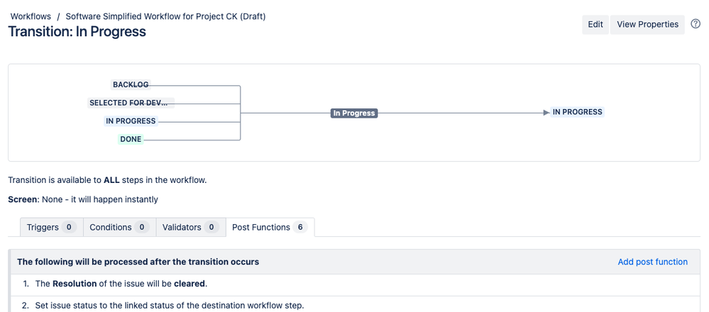

Post function example:
And in the Workflow make sure that the field is automatically cleared when transitioning to non-Done/green statuses.
Given that the field is already set in issues that are in a non-Done/green status, make the above changes first. Then transition each non-Done issue where the field has a value to a another non-Done status to clear the field.

Hi @Noa Tsruya
The second status  which you are seeing is a resolution  you can go to the screen configurations in the project settings and remove the Resolution field from the edit screen
