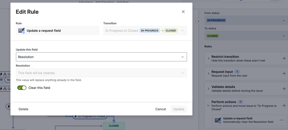

Thanks for your response,used the same in perform action rule ,but still showing same.image (6).png
Sam Okell
December 11, 2025
You have ticked Clear this field, need to untick that and select a value in the box above!
