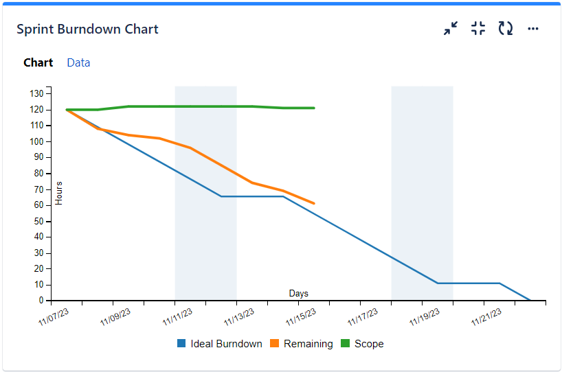

It appears that the burndown chart report of Jira does not consider the Time Spent or Time Remaining; it only looks at Original Estimate field. So, when an issue that has Original Estimate = 3h is marked Done, the Remaining line in the chart decreases with 3h, regardless of Time Spent or Time Remaining.
I'm afraid that you will not find a burndown chart or report in Jira to work in the way you want for team-managed projects. A solution would be search for an add-on on Atlassian Marketplace.
If you consider the idea of using an add-on, our Great Gadgets app has a Burndown Burnup Chart gadget that can calculate by Time Remaining & Time Spent and it works with team-managed projects.
See also this article for detailed steps Tracking an agile project that uses time estimates with Great Gadgets for Jira.

Hi @Diego Palumbo,
The gadget considers as Done all the statuses that are mapped on the last column of the board.
Look at the board settings and ensure that all your done statuses are on last board column.
