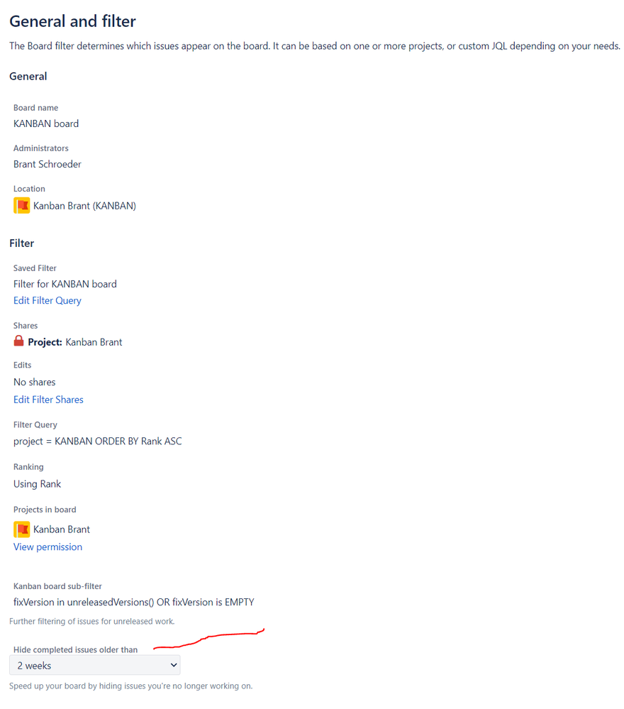

Brant Schroeder
October 19, 2022
@Franer Rodrigues Welcome to the Atlassian community
In Jira Software cloud, in the board's general configuration there is a setting called Hide completed issues older than. The default setting is 2 weeks.  You can change this to 1 week, 2 weeks, 4 weeks or never.  If you choose never you will want to use the filter query to eventually get rid of issues so the board does not become overloaded with resolved issues.
You can access the board settings if you are a project admin or a board admin by clicking on the three dots in the upper right-hand corner.
Then under the board general and filter section, you will see the hide completed issues setting.
