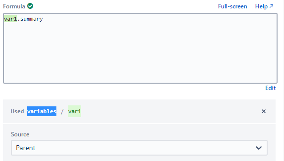

I have a structure to list sub-task. In this structure, I need to display a couple fields from the parent which is a "Story".
I defined a variable "this" as parent and then I can access this.summary and this.status.
But I canno't access this."ABC no." which is a custom field with space and special character. Is there a solution for this ?

Ludovic Boudinet November 22, 2023
thanks for your reply.
Unfortunately, it will not serve my purpose to add the parent JIRA in the structure.
This custom field is of a type "text" and should in theory (at least to my understanding) be extractable.
The issue seems to be really about the syntax and how to use custom field using space and dot when trying to read parent information. If there is a solution or trick to do it, I'd prefer such solution.
I tried:
  • var1."ABC no."
  • var1.ABC_no (because it's written somewhere to replace space with _ and remove special characters for custom fields)
(at the moment I'm evaluating with my JIRA admin to rename this field to remove space and dot but it's a shame as it's used by many teams).
Ludovic Boudinet November 23, 2023
actually, after further testing it seems not working at all to get custom fields this way.
