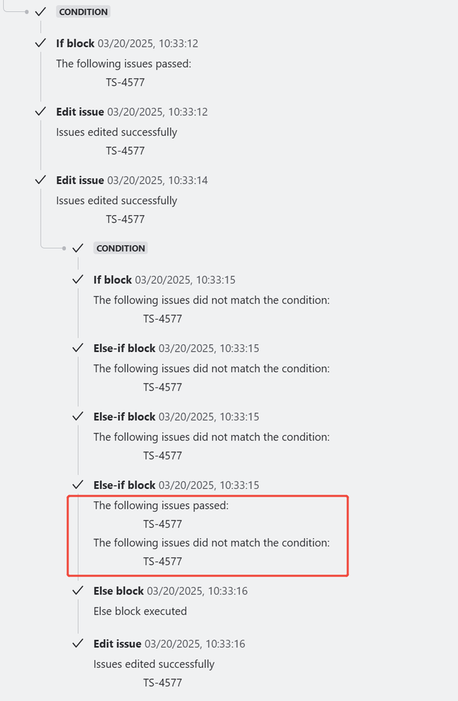

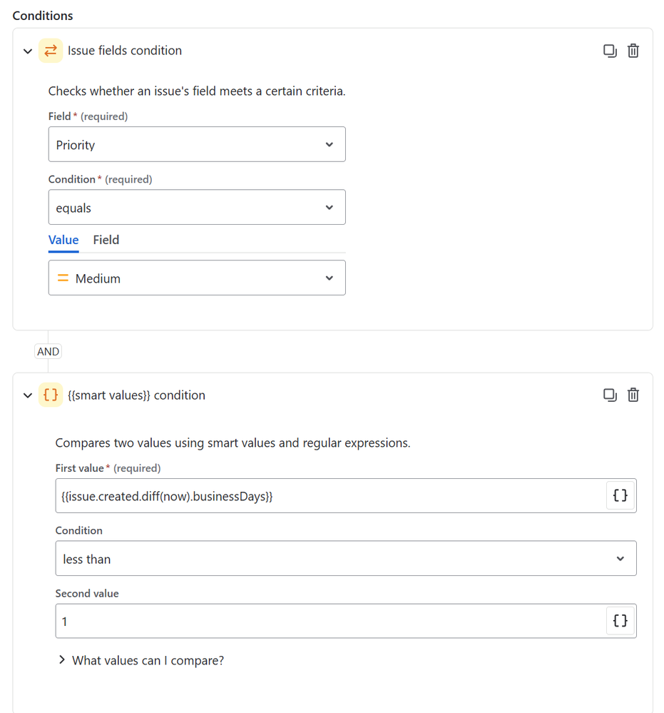

I created a rule as below:
First value: {{issue.created.diff(now).businessDays}}
Condition: less than
Second value: 1
, it said: "The following issues did not match the condition", no idea why it could not passed, the result should be less than 1

It will take complex automation to try to replace the function of the SLA plugin.
In my opinion, you can be inspired by this approach using the smart value {{issue.created.dayOfWeek}}.
If
  • First Condition:
    Check if {{issue.created.dayOfWeek}} is greater than 5. That means the day is either 6 or 7, which corresponds to Saturday or Sunday.
  • Second Condition:
    Use {{issue.created.toBusinessDay.diff(now).Days}}  is less than 1  (but keep in mind there can be inconsistent data, For example, if the ticket was created on Saturday, March 15 at 13:00, the smart value {{issue.created.toBusinessDay}} will return Monday, March 17 at 13:00 )
Then action :
If
  • First Condition:  {{issue.created.dayOfWeek}} is less than or equal to 5
  • Second Condition {{issue.created.diff(now).Days}} is less than 1
Then action :
But this method works if your team operates 24/7, since "1 day" in date-time calculation equals 24 hours.
It’s better than dividing by 8 hours (assuming your team works 8-hour shifts) using diff hours
Hope this can help

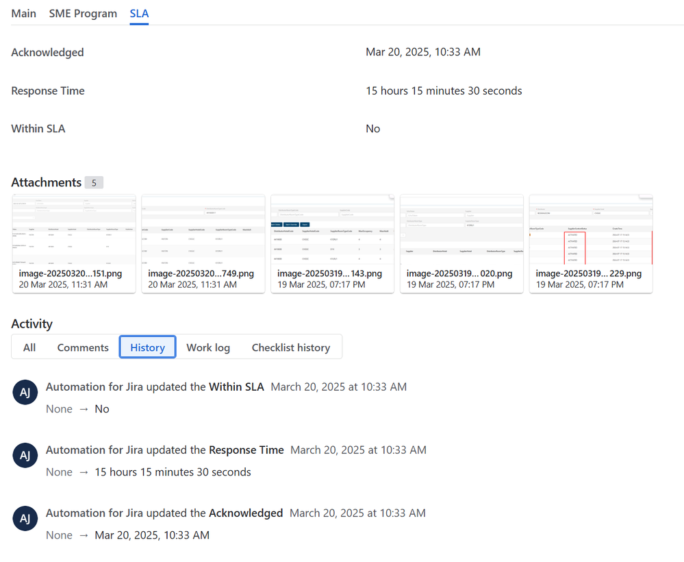

Riven Jing
March 19, 2025
Hi @Mahesh Shinde ,
Thanks for your response! I supposed the result should be 0.X days and less than 1 because the difference is less than 24 hours. Is there any way to do this?
The purpose of creating this rule is to change the value of "Within SLA" to "Yes" if the difference between the current time and the creation time is less than one business day.
Thanks
