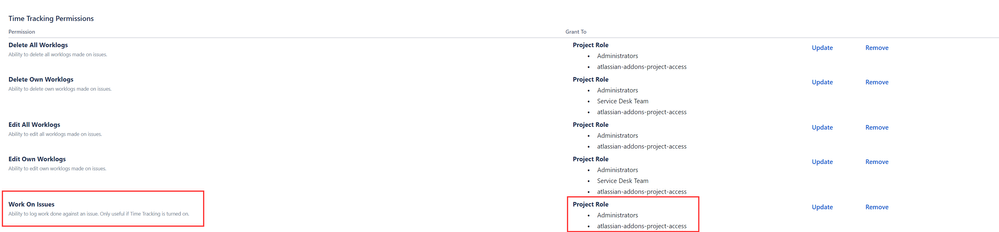

As mentioned before I could reproduce this behaviour with a lacking permission. I removed the "log work" permission for service team users so the field wasn´t shown when I tried to transition an issue with a service team user. See the screenshot below which permission is meant:
Hope this solves the problem or at least brings us a step closer to the solution ;)

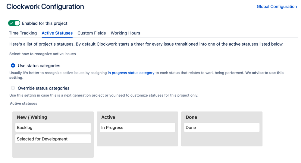

On the other hand, did you consider using third-party apps for time tracking?
I can recommend our Clockwork Automated Time Tracking & Timesheets Free app. It has a  feature that allows users to track time automatically whenever the issue is on the "active" status. You can control which statuses are active. In that case, Clockwork would track time automatically without much involvement from the assignee.7f644892-9796-481f-8baa-f4eafd24b5a6.png
