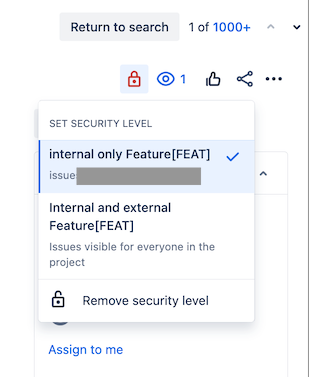

jeroen_wilmes
June 10, 2024
All my settings were correct and worked.
I had problems with changing the security level.
For that there is a different appraoch than changing a "normal" field.
To change the Security level setting you have to hoover over the little red "lock" icon. If you have permissions to change, you will see the change options and can make the change.
I found the information, thanks to helpdesk on:
https://support.atlassian.com/jira-cloud-administration/docs/configure-issue-security-schemes/

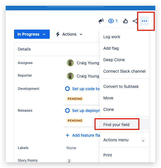

Yong Yang
June 10, 2024
How can I use the field "security level"? Although it has been added to the configuration scheme's and the screens it never shows up as a field that I can change.
==> Please go to one of the issues and at the top right ..., select Find field to triage the reason why that field isn't showing to you:
Just have a try.

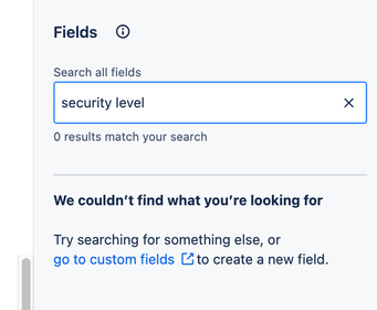

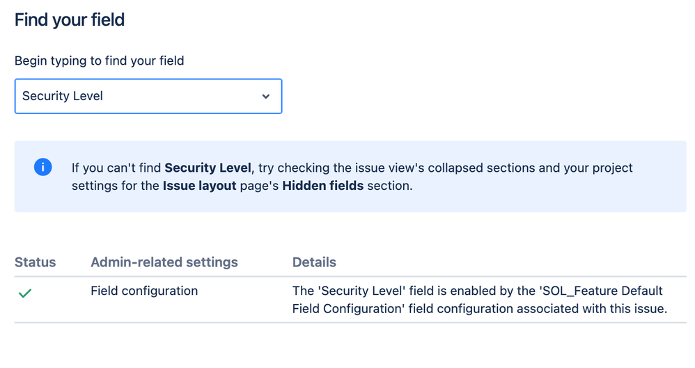

jeroen_wilmes
June 10, 2024
But for one or the other reason I don't have a section "Hidden fields" if I'm on the "issue layout" page nor does the field shows up if I try to search for it.
I am project lead for this project and have admin rights.
