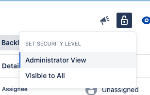

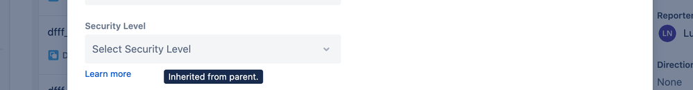

In the Premium instance to which I have access, I don't see the Security Level field at all on any type of task. Instead issue security is set by clicking on the padlock icon at the parent issue level.

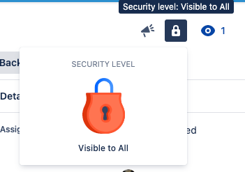

On a Subtask if the parent doesn't have a security level set, then the padlock icon doesn't appear at all. If the parent does have a security level set, then in the subtask the icon is present and I can click on it to display the inherited security level, but I can't change the level for the subtask.
