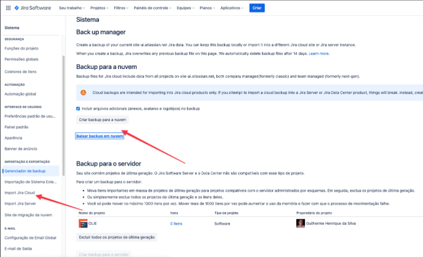

I've used that migration method:
and I belive that is the right documentation about that function: https://support.atlassian.com/jira-cloud-administration/docs/export-issues/
its generate a .zip to be imported
