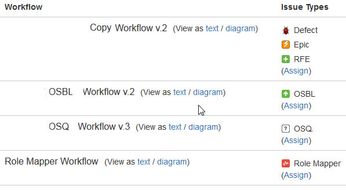

I have these workflows
I created a developper group with multiple users.
I would like that only users on developper group have a visibility on  OSBL&OSQ issue type.
I have seen that some posts say that this is not possible, but they are old publications. Maybe is it possible today.
I have few clues with Issue Security Scheme and post function but I do not know how can I do ...
It would be great if someone can help me !!

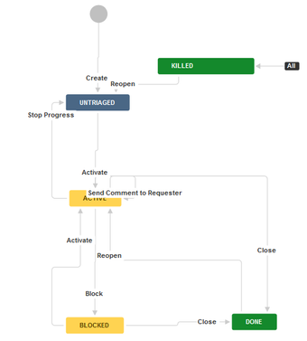

Nic, when you say "In workflow A, add a post-function that sets the security level to "secured"", on which transtion I apply this post function ??
On the first transition "Create" ?? If I do that the users will still able to create issue but only developer group can see them
This is my workflow
Nic Brough -Adaptavist-
June 26, 2017
You can apply it on any transition you want.  Most would put it on Create because they want to hide the issue for its whole lifecycle, but for your workflow, I would consider doing it on activate.  The users would then see that they've created an issue and everyone can see it, but as soon as you activate it, it would disappear from their lists.  You'll be able to explain "triage means we remove it from view" more easily.
