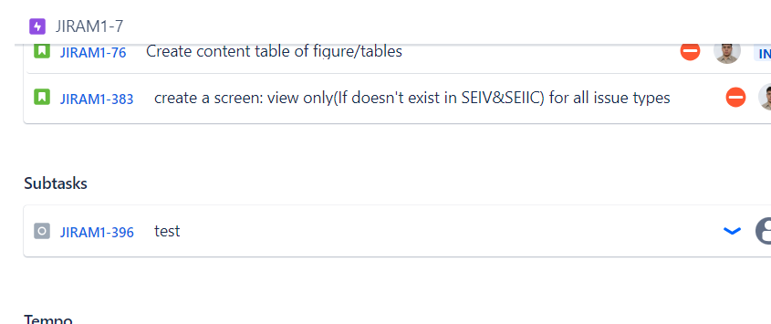

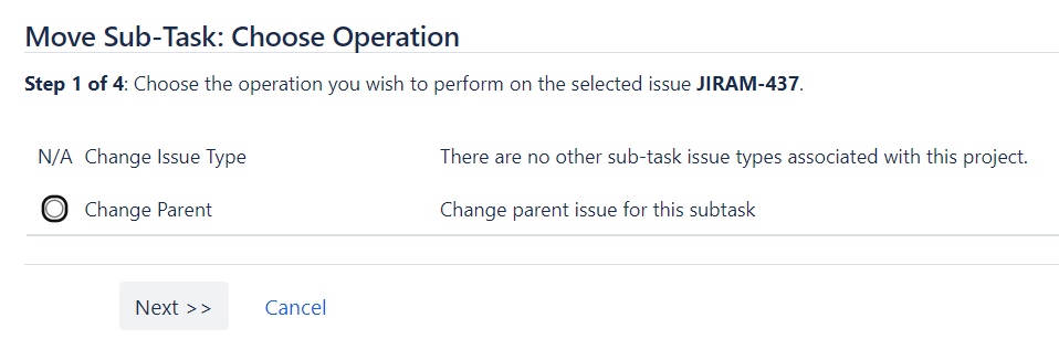

David Plesu
November 24, 2023
Hello,
Thank you for the quick response.
I don't think I was clear enough.
Let me explain one more time:
I have a sub-task, that is under a user story, which is good!
Now a user go in the actions of the sub-task, and are clicking "Move"
 Now they select "Change the parent" - this operation is correct, and they should select a new user story.
Instead they select a epic, and this is working here. And automatically the sub-task parent is the epic. And the user story is missing.
Thank you.
Best regards,
David.Screenshot 2023-11-24 141811.pngScreenshot 2023-11-24 141512.pngScreenshot 2023-11-24 141422.png
Kristian Walker _Adaptavist_
November 24, 2023
Hi David,
I can confirm with ScriptRunner that for Jira Cloud it is possible to restrict issue types only on the Create screen currently with Behaviours, and the example here shows how to do this.
Also, this documentation shows what fields behaviours support on the Create Screen and what fields it supports on the issue screen.
An alternative approach would be to use a Script Listener and to check when the issue type changed in the script and if the issue had subtasks and if it did to change it back to its correct value and add a comment saying it was changed back.
I hope this information helps.
Regards,
Kristian
