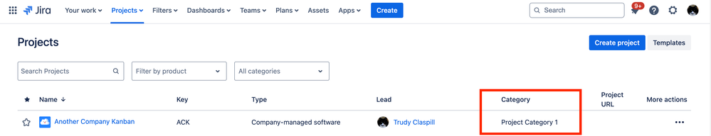

The Project Category for a project can be viewed on the View All Projects Page under the Projects menu.
Is that the information you want?

I want to know what the category name is from the key-part of an issue. So if i have a look at your image.
I have an issue ACK-1234
the key part of this issue is ACK
So no i want to know what the categoryname is belonging to this key .
And all in JQL.

Also, for clarity if you have issue ACK-1234 then:
"ACK" is the Project Key for the Project that contains the issue.
"Project Category 1" is the Project Category associated with the Project.
